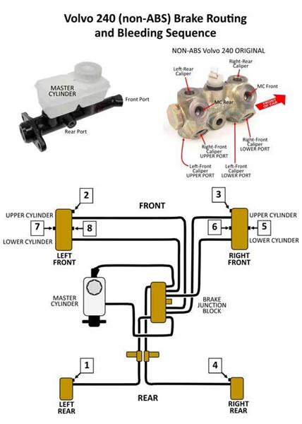

https://www.240turbo.com/volvo240bigbrakes.html
