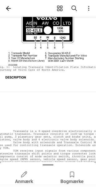

https://www.volvoclub.org.uk/tech/service/850/AutoTransDiagnosis.pdf
